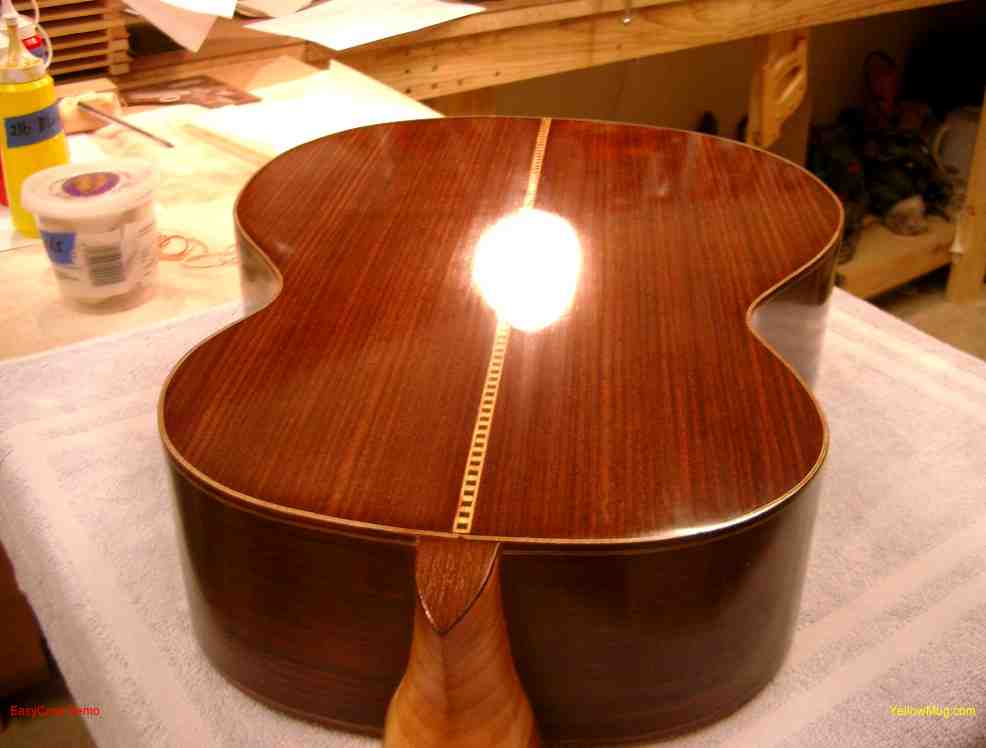

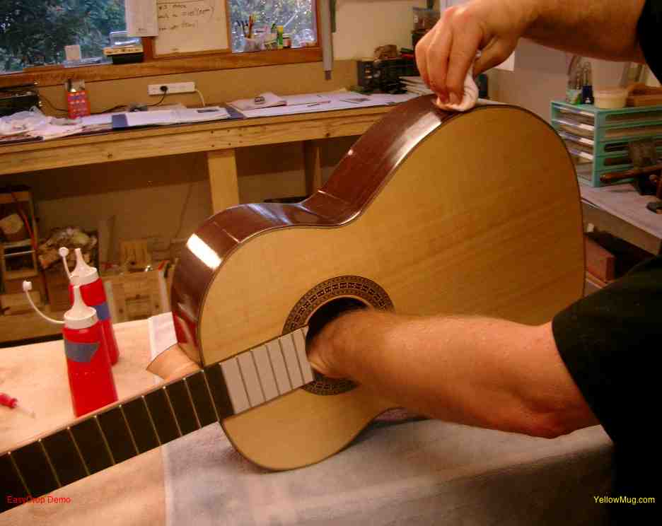

PostPosted: Sun Sep 10, 2006 10:14 am
Posts: 1055
Some progress pics of the French Polish job in progress. I ended up doing 4 pumicing sessions. Had to apply another spit coat after 3rd session. I would have gone for a 5th session but colour was starting to leach out of the IRW.
Pics show guitar after on bodying session. Still following Milburn brothers tutorial. Man I just loooooove that little plume that trails behind the muneca!!
PostPosted: Sun Sep 10, 2006 2:23 pm
Martin,
That is looking quite good! It seems as though it will definitely be worth the effort you've had to put into it.
PostPosted: Sun Sep 10, 2006 8:51 pm
Posts: 1055
Thanks for the positive reinforcement Carlton!
Onto the 3rd bodying session.....a few little blemishes here and there but managed to work them out with 1200 wet and dry lubed with olive oil. Still not 100% happy with the pumice fill job but hopefully after a few more body sessions things will look better. kiwigeo38971.2446527778
